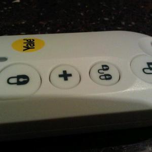

    By the way the hoover is a Vax Mach 1, bought in UK. Would be a shame to lose the keyfobs we want to give them to people when they come and feed that cats. We are away from home quite a lot.

    Its a 6200 with the grey keypad and i've only had problems since I learnt in the keyfobs. They are never kept in pockets we keep them hanging up and the buttons are flush with the case, they have to be pressed with a reasonable amount of pressure to activate. Going to investigate tomorrow...

    I've had no problems with this alarm until recently I bought a couple of keyfobs, I learned them in and they work fine but since then the alarm has been going off at seemingly randon times when we are home. After investigation I now know that every time I hoover it sets the alarm off! It...
