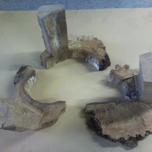

    Repairing raw timber piece
    Yep, it's been air dried for about 6 or 7 years. I like the idea of the "exploded diagram" though, will have to experiment with the pieces Any tips on lining up dowel holes on the adjacent faces? Getting a flush fit of the pieces would require them to be pretty exact, or would I drill one of...

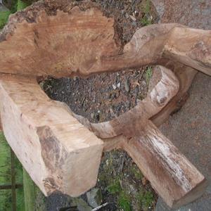

    Hi there, I recently purchased a fairly unique piece of burr elm, with the intention of making it into a coffee table- [ Unfortunately, when it arrived, the careful carrier company had turned it into this- Now, I was planning to make a glass or epoxy top for this to show the...
