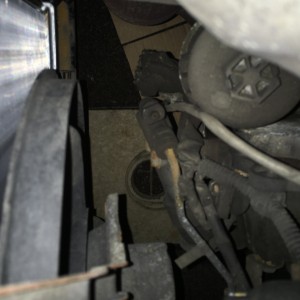

  12. mrmike
    Peugeot 207 Radiator Leak
    Yes I will keep an eye on it. In the picture, if you look to the left of the oil filter housing there is a black cylindrical shaped thing with a pipe sticking out of the bottom of it, it is this device that has some sort of bleed nipple on that I was referring to. Think I might buy myself a...
