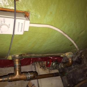

    Cheers D_ Pardon my ignorance but what is a gate valve? Just a regular valve? There is a largish round red-handled valve near the cylinder which I *think* is on the return pipe - might that be it? To balance it, would it be similar to rads? What sort of temperature drop should I aim for...

    Hi there, I have a Y-plan setup (Ecotec plus 630 boiler, Honeywell timer, roomstat and cylinder stat) heating rads and a hot water cylinder. I'm 99% certain the valve is wired up correctly and switching properly, but when there is demand for CH and HW, the rads all drop in temperature quite...
