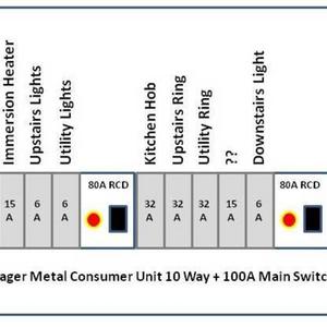

    I was hoping that some of the members that helped me understand the issues surrounding installing some new electrical circuits for a new kitchen/utility room might have a quick look at the attached circuit layout. The proposal is to replace the existing fuse-box and 6 circuits with a 10-way...

    Circuit

    Just wanted to say thanks for all the knowledgeable advice - its been an education plus thanks to DIYnot.com for providing the website. I think I now have a pretty good idea of what I can do for myself and what I need to sort out with a professional electrician. P.S. thanks for all the...

    Thank, I think I am now reasonably clear on the basic layout. It is the fitting of the CU and potential problems with the RCDs that I now need to get clear in my mind. However, there is one other issue that somebody might be able to confirm regarding who is allowed to connect to an existing...

    John, the following link supports what you are stating for method C being used. I will give it some thought. I guess I was considering whether the 6mm would allow some flexibility to up-rate the MCB to a higher current should the wattage of some of these multi-ovens and induction hobs go even...

    Many thanks for both replies, which were very helpful. Yes, it would seem that 10mm cable is an overkill. For the type of oven and hob that will be fitted, now and in the future, I think 6mm cable on 32A MCB is probably a reasonable match to the requirements. Very good advice. Would this...
