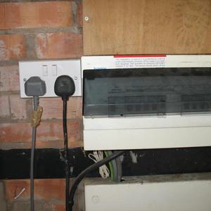

    Extra Sockets in garage
    Thanks for that. - your reply came in whilst i was typing the last. I understand what you mean. It just basically one length of 2.5mm acrss to the new sockets, and a new 20A breaker fitted, dedicated for the garage sockest, yes? -
  2. N
    Thanks for the prompt reply. Excuse my ignorance, would that be a dedicated ring for the garage then - or radial? - I assume if ring it would need two lengths of cable to the other end of garage. Now you are talking fitting new MCB's im not going to be doing it myself, but it would be good to...
  3. N
    Firstly, thanks in advance for any advice offered.... I have just one double socket in the garage. Its right next to the main distribution panel see pic http://www.diynot.com/network/nastylizard/albums/ Theres just one set of wires inside the socket, (so is this a spur?) and they look...
