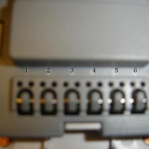

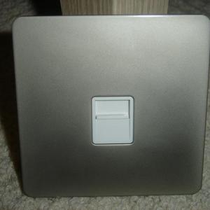

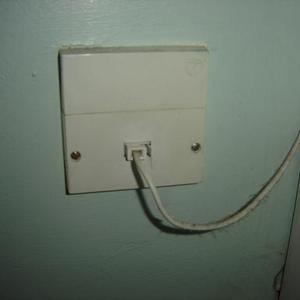

    Telephone Socket Change
    Dammit, I just looked on the packaging and it says it is a secondary telephone output. Which is no good right?? Thanks
    Hi All, I have changed all the switches and plug sockets in my house and now want to change the telephone socket. Is it going to be possible to swap the old socket in white which i believe is a NTE5 socket, with the new silver flat plate one which is also pictured. I have also added a...
