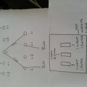

    Hi All Thanks to all who replied. Stripped everything down and checked outside lights wiring and bulb, as this was the one not working. Rewired all wiring back in from original drawing I made when changed the light socket. Now everything works. :!: :!: :!: . Can only assume there was a loose...

    Yep typo, earth comes in and out of back of back box.

    3 Way Light Switch
    Just noticed that I have another red wire at back not connected to anything. Copper cable is flush with plastic sleeve but may have snapped, not sure !!!

    3 Way Light Switch
    Hi Andy thanks for you quick reply. I replaced the existing outside light with a new one and at the same time replaced the old brass switch inside to a new plastic one. I did take note of the wiring but thinking about it now only the colour not the exact position of the red except for the com...

    3 Way Light Switch
    Hi Folks. I have a slight problem with my 3 way light switch. Outside light not worked since I fitted it. Got fed up with it so gave up. Now dark nights have arrived need to get it working. See picture below. Any help would be gratefully received. :lol:
