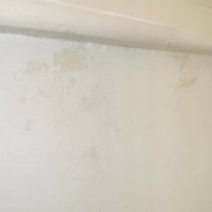

    Damp Under & to Side of Sash Window
    Thank you for your suggestions. Hertsdrainage2010, you're a complete star. You're right, I remember one of my housemates saying she'd seen water coming from the overflow one night, and I have had problems with limescale clogging up the float value in the past. I'm going to get it fixed and...

    After living in this house for 14 years, three patches of damp have appeared under and to the side of an external sash window. The strange thing is that the other side of the wall abuts to an extension roof and is not exposed to the elements. There's a groove under the cill, the seals are...
  3. Damp Patches - Close Up
