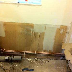

    Bath waste connection
    The bath needs to be raised 50mm yet, it should have a slope on it & was hoping to tee into the side of the 110mm plastic with a clamp on boss? Whish u can just see in the pic...
    I have managed to get the new sink into the old bath connector (on the left of the stack) Now I want to pipe the bath waste into a strap on boss into the side of the soil pipe from toilet. Does this look reasonable ???

  6. N
    Hi, I have bought a flat built around 1950 I think, I have ripped out the bathroom & I am looking to replace the suite. I have done quite a few bathrooms in the past but i`m not sure how to tackle this. The soil stack is galvanised steel, it supplies the flat below also, but I cannot get...
