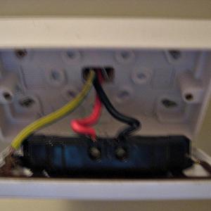

    Great thats what I thought. Id bought most of the components already. I was going to confirm everything with my electrician mate before I did anything. (or hopefully convince him to did it for me ;) ) Only the cabling left which I was going to buy was the the 32 amp cooker cabling from BandQ...

    So how would I connect up both from the single set of wires? Just wire to one and then get some extra cabling and link to the other?

    Ok, thank for the help Its hard to check everything as the whole lot has been tucked behind cupboards. Plus Ive only moved in a year ago so all the setup was done by the previous owners. From the fusebox: Ive got a 32A Cooker on the fusebox Connected to the 32A cooker socket...

    Thanks for the quick reply. Unfortuanlty the oven I had my eye on was a double at 7kW as I was hoping for a oven and seperate grill. My second choice was single oven but thats rated at 3.5kW. Oh well, I'll have to see how much a rewiring would be or lower my standards for a...

    Just a quick question. My built-in oven doesn't heat anymore, but as its old i've decided just to get a new one. Its an electric built-in oven with a separate gas hob. I was examining the connections and fittings I noticed that the Oven is connected to a standard 13A double socket...
