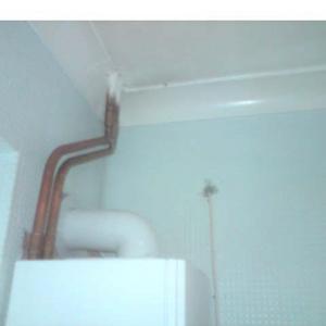

    Hi all, thanks for the replies. Corgi man did indeed arrive (early) but although he requested the Installers to be present, they didn't send anyone. He contacted them and they explained that they hadn't been able to send anyone due to being short staffed :? CORGI guy was here for just...

    Thanks for the reply. The Installers came out again this morning to check the work their men did yesterday :? They switched over some wiring in the boiler ( I think they were something to do with sensors ) and the boiler now fires up and seems to run OK. I asked them if they were...

  8. Boiler Pics
    Boiler Pics
  9. N
    I need a man that can.....
    I had the boiler fitted in July this year, and it's never worked properly. When they first fired up the system, the F23 code kept kicking the flame out. Not technical speak I know, but I'm not sure of the correct terms. The installers fiddled about inside the boiler and eventually, the fault...
  10. N
    :oops: I need a man that can advise me about something... I have a Vaillant ecoTEC plus 428 that keeps cutting out I get the code F 23. My question is...will it be OK to keep pressing the little 'flame' button to over-ride the fault code so that at least I can have a bit of heat in my...
