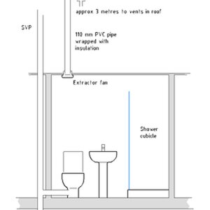

    Yes, there is a more fundamental problem with the capping on the vertical flue, which I'm not prepared to address just yet! The existing fan is woefully inadequate and in the wrong location, and has no condensation trap. I think most of the moisture is running down the inside of the vertical...

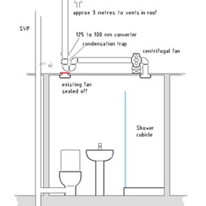

    That's great, thanks. I figured the thrust from the fan would be better immediately after the fan, and hopefully allow the shutter to open wider.

    Hi John I see what you mean. That was why I was considering an S-bend at the bottom of the vertical flue to trap water and debris. I would make a point of clearing it out every six months (hence the litter tray). But an S-bend may restrict the flow too much, so perhaps I'll try and put a...

    Hi guys Thanks for your responses. I've updated my diagram to try and eliminate the U-bend and make the airflow less restrictive. I've also found that this company do a 110 mm to 100 mm convertor, so it should seat the vertical pipe a lot better...

    Thanks for getting back to me. I like the looks of the Soler & Palau unit - it's like something you'd find under the wing of an airliner! It's a little pricey, though, and I'm not too concerned about the decibels. The noise for the existing Manrose fan is quite obtrusive, so anything I fit...

    Hello again, everyone. It's been a while, but I have my next project that I would appreciate some input, please. Background: - First floor flat, with access to loft space. - Internal shower room with no window, no external walls. - Existing Manrose extractor fan is located in the ceiling above...
