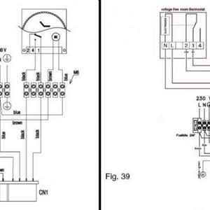

    salus rt500rf programmable thermostat with sabre HE25 boiler
    for anyone who reads this, n maybe needs help with the same issue, just zoomed into the picture and noticed that 2 on the stat, according to sabre, is COM and 3 is ON. Not sure if ON is same as NO (it is 'NO' as according to salus). Will find out wen its wired up. Or leme kno if u kno. Wont be...
    Hi, im wiring the Salus RT500RF programmable thermostat to a sabre HE25 boiler, which doesn't have a wiring loop/jumper (the one you usually remove for the thermostat). The salus stat has 5points; 1. NC - Normally closed, so ignore this one (In the diagram for 230V application, this is...
  7. sabre he25 wiring thermostat
  8. sabre he25 and salus rt500rf
    wiring diagram
