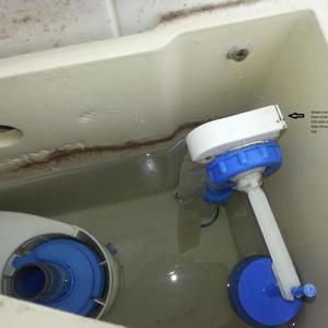

    Cistern water too ferocious!
    Well I was watching it and the water is not flowing through the polythene pipe, definitely coming out of the side where I've indicated with the arrow in my 2nd pic
  2. O
    hmm..pretty sure it's flowing over the top - see new pic
  3. O
    Thanks, but can't see anything immediately apparent. I've uploaded a pic if that helps. The white part at the top right is where the water gushes out and hits the side of the inner cistern wall
  4. O
    I have a fairly modern push button cistern. When I press to flush, and the float arm lowers; the water splashing against the side of the inner cistern wall- at the top- has become very powerful (presumably coming from where the ball valve has opened?) and proceeds to splash over the lid and...
