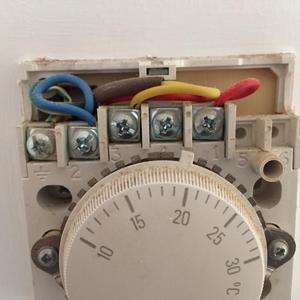

    SOLVED - Wiring in Drayton Digistat +3 from old Honeywell
    Many thanks to all who helped on this. The answer was: Common - Red On - Yellow. Seems to be working and has not blown any fuses. thanks again
  2. P
    Thank you all for your comments. I'm still a little confused. Should it be? 1 (Red) Live- C 3 (Yellow/Brown) Switch- On
  3. P
    I have just taken the readings Boiler on and Thermostat calling for heat: Red - 240v Yellow - 240v Blue - 222v Boiler on with no heat called: Red - 0 Yellow - 240v Blue - 222v Boiler off timed and not calling heat Red - 0 Yellow - 12v Blue - 12v Any ideas? thanks
  4. P
    Thanks for looking. I have double checked and this is what I found: When the boiler programmer is on (Thermostat closed): T 2 - Live T 3 - Live T 4 - Nothing T 1 - Nothing When the boiler programmer is on (Thermostat open): T 2 - Live T 3 - Live T 4 - Live T 1 - Live
  5. P
    Hi all I hope someone can help? I'm trying to wire in a Drayton Digistat +3 22083, however the wiring instructions has lost me! This is my Honeywell The blue & yellow/brown are live and when it calls for heat the red then becomes live. Is this correctly wired? The Digistat...
