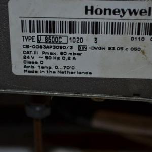

  5. P
    Ideal ConcordeWCF-255A - not firing up
    I have uploaded a photo showing the 240 volt black terminal and the barcode label on the old one showing the 24volt which is the same as the new one
  6. P
    If it had been sent out with 24volt on the terminals or it was blue, I would have sent it right back. The connection block is black meaning 240volt and actually has 240 volt stamped on the side. The valve that came off the boiler was exactly the same, 240volt on the connection block. The...

  9. P
    I hasten to add that the gas valve is exactly the same model as the old one - 240volt on the connector block and on the barcode label 24 volt - see pic in my folder named 'ideal gas boiler valve'
  10. P
    The valve has the usual Honeywell barcode sticker on it which gives the model, spec., etc. On that same lable it says 24volt. On the part where the leads connect to the valve it has 220/240volt. This problem started when the old valve was on connected to the boiler. I remember turning the...
