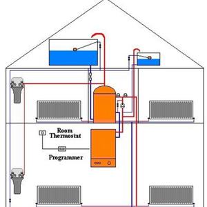

  6. P
    Conventional Central Heating Mystery Pipe?
    Not all, the hallway, utility, toilet don't, rest have. Below i have added a diagram i found which shows a similar set up to mine, only one i could find showing this bypass pipe/valve.

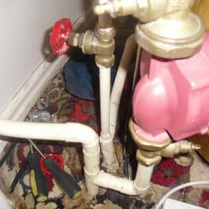

  7. P
    The main pipe from the bottom of the cylinder comes out and then down through the floorboards,the 15mm pipe with the valve on joins this on the corner with a tee peice (15mm/22mm/22mm), hopefully i have added a new photo below which might show this better.

  10. P
    I should have moved that out the way before taking the photo, probably looks confusing, i bought it to replace the current one as i thought the current one was goosed, it was making strange noises but then was ok again so i put it down to other problems, might change it over anyway at some point.

  12. P
    i have tried to add a photo, not sure if i have done it the correct way, i clicked upload picture, then created an album called heating and added a photo to it, let me know if you can see it and that i added it the correct way. I have highlighted the pipe in question and the manual valve...
