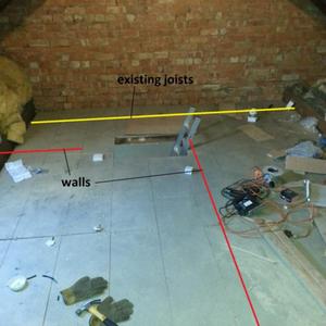

    I have a photo below showing supporting walls ,i might be able to create the butt joint 500-1000 mm away from the timber end and then bolt them together using rsj splice plates http://media.diynot.com/229000_228879_93873_29217491_thumb.jpg

    Any ideas how a 5m span be covered by a joist cut in two? maybe splice plates and then a piece of timber on either side bolted together and maybe the butt joints be created at different points on all the joists .

    Hi everybody I am currently thinking of installing a loft floor by myself . It will be 5m clear span with 600mm centres using C24 2500mm x 75mm x 225 mm timber butt jointed together to make 5m joists because its the only way i can get the timber in loft. I was planning to butt joint using...
