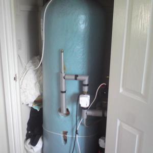

    Warm water from hot water cylinder.
    Hmmmm I have done 2 things and one appears to have worked. I took the thermostat off the cylinder and laid it on the floor, and I have bled a bit of air from the hot pipe and now the water is hot. I am curious to know which has worked ???
    The hot water pipe going into the middle of the cylinder coming from the motorised valve is really hot. No the central heating is not turned on but that works fine. There is a small bleed valve on top of the pipe which fits on top of the hot pipe which I have bled and a small amount of air...
    Hello Mick Sorry what do you want me to put thermostat temp. on initially. At the moment it is clicking on about 25 degrees. It is the strap on type. OK turned thermostat right down, turned hot water on and waited. Nothing then turned thermostat up and like you said Mick, after about 10...
    Hi Cylinder stat was set at 60 degrees. Turned it up to 90 but it made no difference to water temp.
    Can anyone please help? The hot water from my cylinder supplied from my boiler has gone luke warm. The pipework before and after the motorised valve is hot before it goes into the hot water cylinder. The central heating is working fine. I have a conventional boiler Suprima, the Cylinder is...
