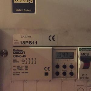

    Santon Premier Plus Boiler
    This is what i can see

    no i am on a standard electricial account. I checked which account i was on yesterday. It was wierd because at 7am yesterday i didn't have hot water. But then when i got back from work at 18:00 i did. Very strange. Should the santon just heat up the water to a certain degree and leave it...
