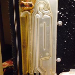

    Bosch Dishwasher wont finish cycle
    Thanks Yardie Will try that later on. Thinking about it again this morning (as you do) I reasoned that the reason that the float switch is not cutting out the water intake, is because there is waste water syphoning out of the machine through the drain pipe of the matrix. The valve at the...
  2. P
    For some reason my Bosch Dishwasher has stopped working properly. Main fault is that it will reach the end of the programme but not switch off as water flows in and the drain pump keeps attempting to drain the machines. Clean water will sit in the bottom of the machine I looked at other...
