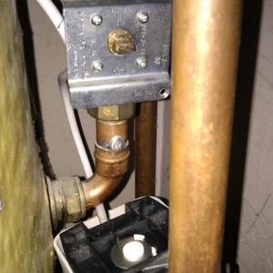

    Just a quick note to say.... Fixed! I tested the frost stat with a multimeter and it was fine. So I tested the zone valves and turned out the microswitch inside the CH zone valve had stuck on. I replaced the actuator with a new one. Wired it back up carefully and all works great! It's been...

    Hi all A quick update. I've had both CH and HW actuators off their valves and I've tested that they both do turn on and off properly as the CH/HW/cylinder stats and programmer all require. So I'm satisfied that both valves turn freely and that the motors in both actuators are working...

    Hi Dan I removed the motorhead and the screwdriver-like head underneath (is this the spindle?) is perpendicular to direction of flow. I can turn it fairly easily with my fingers. Pic: Both CH and HW values are Sunvic SZ 2301 units. There's a flushing lever on each one: when I move the...

    Hi there I'd really appreciate any advice regarding this problem, before I call an engineer out. We moved into a new house last year. CH and HW all seemed to work fine. However the pump is on 24/7 - even when the room thermostat and programmer are all off. Initially the problem was...
