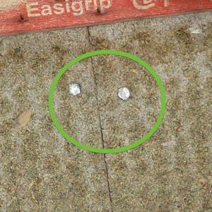

    How to remove nails from floorboards?
    @PrenticeBoy - Thanks for your suggestion. The more I looked at other forums, the more I am worrying about it's the T&G type of chipboard and extends across two rooms. Then I might have to saw it! Other people have suggested circular saw, hole-saw... etc. Hope I don't need those ...
  7. P
    Hi all, I have to lift some floorboards to see if there is water leak. However, i'm a bit stuck. I have a pry bar but there is no way I couldn't get it underneath the nail head and pull it out. Do I have to cut the board around the nail head to make some room? Here is a photo...

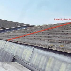

    Roof leak due to faulty work
    Hi tony, regencyroofing, alastair, Thanks for your comments. The roofer has already installed lead soakers which he claims should stop water at the tiles/parapet wall interface. However, the leak is still there, and from the attached photo, it seems water still running onto the ceiling...
  14. P
    @tony : hi, could you please elaborate what's wrong with the flashing? I am no expert so would really like some advices so that I know what to look for and talk to the roofer. Thanks! @alastair : The Redland technical advisor suggested me to strip off the roof and re-laying the tiles...
