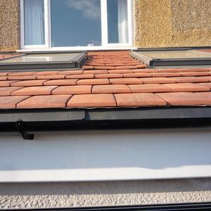

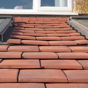

    Velux Flashing advice
    Hello, thank you for reading this post. We have recently had an extension built and I am after some advice about Velux flashings. The builder/roofer have Sandtoft 20/20 tiles and the pitch of the roof is 15 degrees. The problem is that the tiles either side of the Velux windows seem to bow...
