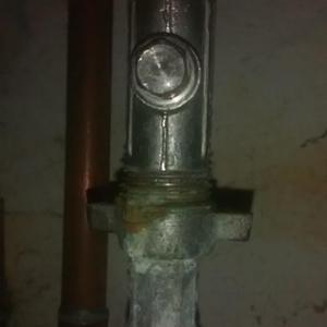

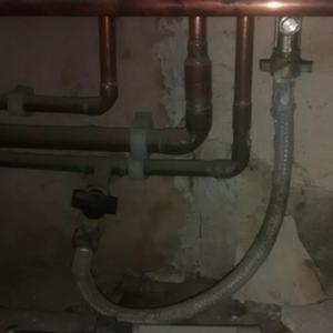

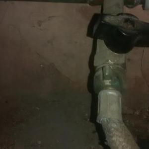

    Vaillant Pro 24 with only one tap on filling loop
    Thanks for your reply. It doesn't go vertical but moves slightly anti clockwise. I have done that and although I can hear a faint watery noise it's not a whoosh like I'd expect and the pressure isn't increasing. I can't find anything that could be turned other than the hexi thing. Any other...

    Sorry new to the forum but figured it out now I think! Can you see the pics now?
  6. P
    Hi, My boiler is extremely low on pressure and some radiators aren't filling at all. I can't increase the pressure as I only have one tap and all the guides I have seen mention 2 or screws. Mine has neither! Can anyone offer some advice? Thanks :) I have an album here with pics of the...
