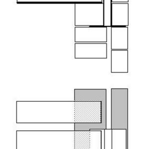

    Thanks guys, sounds positive, but just to confirm, I think I will be using a catnic CG50/100 lintel bearing on a padstone over the garage opening sandwiched between another padstone sitting on the inner leaf and inner lintel flange which then bears the 254x146UB. The masonry column is already...
  6. P
    LINTEL BEARING
    just trying to get round an emerging problem. In the middle of a build and have a situation where two lintels converge on a pier. One is a UB and the other over a garage door is a Catnic cavity lintel due to the fact that the long UB has had to be repositioned on the pier to square up with the...
