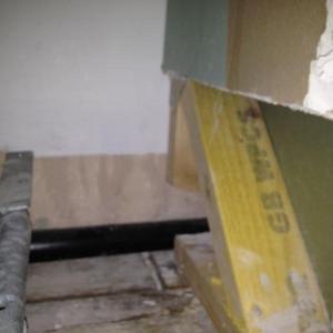

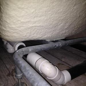

    Adding air admittance valve between bath and shower traps
    Interesting. I will have to measure the fall on the pipework, though (Hepvo needs at least 10° it seems), and it's pretty tight against the wall and the floor - I don't know if the compression fittings on a hepvo would fit. I had planned on using a solvent welded tee for that reason. Suppose I...

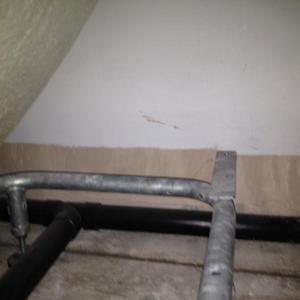

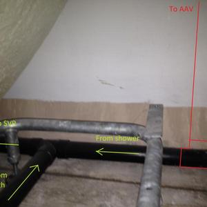

    Occasionally we get some bad smells when the bath is emptying, accompanied by gurgling sounds from the shower trap. I think this means the bath emptying is sucking the water out of the shower trap, which can be addressed by adding an air admittance valve. Am I right in thinking that the AAV...

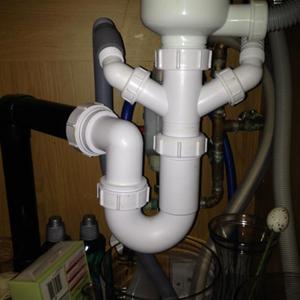

    Smells from sink when appliances drain - need anti vac trap?
    Great. Here's a pic of the trap: It's a McAlpine trap. The outer diameter of the black waste pipe is 42mm; that makes it 1.5 inch, correct? Am I right in thinking that if I buy a McAlpine SC10V, it will just replace the lower section without having to alter any of the pipework...
    Hopefully this is just a quickie for those in the know :) We're getting some pretty minging smells from our utility room sink whenever the dishwasher or washing machine drains out. Both appliances have their wastes connected into the sink trap, via this kind of arrangement: Am I right...
