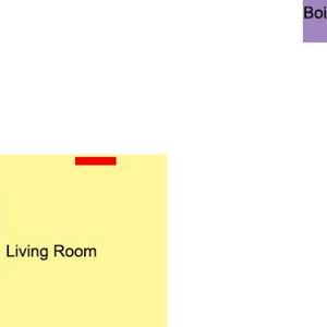

    Not sure if this makes things any clearer, but the positioning of the radiators. I haven't drawn all the downstairs rooms as all the radiators work apart from that single Living Room one. Red is working, Blue is not working.
  4. Untitled
  5. Untitled
  6. Radiator positioning

    Pipes to radiator bent?
    We have recently had a new boiler fitted, new rad valves, system drained & a chemical power flush. There are a few radiators that do not warm up correctly or at all. The plumber also drained the radiators in question again and checked all valves, balanced system etc. He said the plastic pipes...
