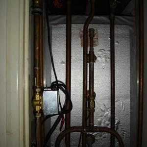

    Water in Bathroom Dried Up
    Hi In my original post I said the water tank was full. I was mistaken, the Harcopak cold water tank is split into sections, only the small section is full. If I hold the ballcock in the small section down, the larger section starts to fill up with water, unfortunately this pushes the water...
    Hi Mike, I've tried using a wet vac on taps, it sucked out the remaining water in the pipework, but the water has not started to flow. I kept the vac running for a few minutes. Is there anything else you can suggest? Thanks PG
    Hi, For no obvious reason the water stopped flowing from the hot and cold taps in my bathroom (both at the same time) and the toilet cistem has stopped filling up. The water supply for all three comes from Harcopak water tanks. I've been able to check the cold tank and it is full. Even...

    Air in Harcopak tank
    Just thought I would let you know, I turned the pump speed back down to 2, and the noise has stopped. I tried bleeding the system, but no air was released. Once again thank you for your help Mike and clf-gas.
    Thank you both for your help/advice. The heating engineer turned the pump speed up 3 from 2, because of my 'sluggish' system. Before I bleed the tank would you suggest that I turn the pump speed back down to 2?
    Hi, I have Harcopak water tanks fitted in my house. When I turn the heating on, roughly every 30 secs there is the sound of air in the hot water tank/pipes surrounding it. This started following a visit from a Gas Engineer, who I called out to repair my boiler, but who was insistent the problem...
