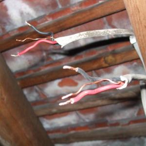

    Everything is now all sorted! Uncle Jamie came round and fixed everything. There was a loose wire in the ceiling rose of my son's bedroom. God Bless Uncle Jamie. Thanks to everyone else for their efforts. Cheers. :D :D :D

    I have re-attached the previous rose and bulb and that is still not working. I've got a multi-meter now and I have done a continuity test on the Switch wires and that was ok. I'm not sure what I should test next with the multi-meter?

    Just an update: I took the fuse out for the 'downstairs' lights and the light on my landing wouldn't work. Once the fuse is back in, it works fine. So I guess it is definately on the downstairs circuit.

    Hi guys, thanks for your replies, this is where I'm at now: I have traced the two sets of wires back; one set goes back to the switch on the landing and one set goes back to the ceiling rose on the landing. So I guess my set up is more like this: I have wired it up as per that...

    Please can someone help me? I am trying to change the light in my loft from a regular bulb holder to a fluorescent tube. There is a switch on the landing and it worked fine but I just wanted a brighter light up there. When I took the bulb holder down I didn't make a note of what wires went...
