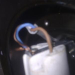

    New light fitting not working
    it is the new cable that is earthed in the switch box. I have the following connected to the light fitting: brown, blue and the earth connected to the earth point on the fitting.

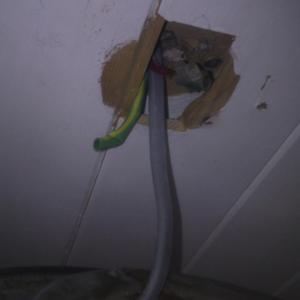

    no more wires/cables in the space coming out of the loft
    the earth sleeving contains two black wires looped. found it that way? only earth I can see is the one that is bare. Will have a route around in the space but not very big

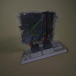

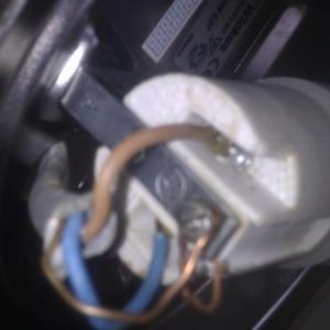

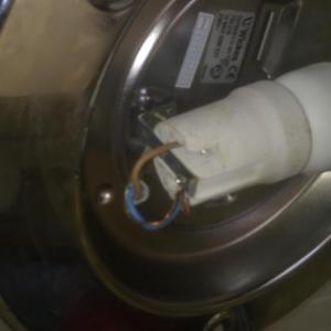

    [http://www.diynot.com/network/user_album.php] hopefully you will be able to see the pics I have taken. showing switch, wires and light fitting.

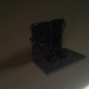

    thank you all for your help so far. I am going to take some pictures of the wires and fitting etc and post them on here if possible. That way you will all be able to see what I am trying to describe (Poorly). this would of been my first step had i got there before the lovely Mrs Pots!

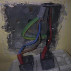

    There is no black wire in the cable including the blue, brown and earth. two blacks are separate and looped - feed back to the switch (double switch) one for bedroom other for ensuite, 2 reds also looped
    the brown, blue and earth all run to the switch. both the red and black are separate and are in blocks
    yes there are two reds in a block and 2 black also in a block

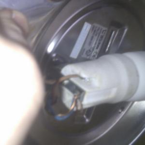

    Hi new to the site and need a little advice please. we have purchased a new light fitting for the bathroom, meets all regs and requirements. However, my wife removed the old fitting and got herself a bit of a shock, light switched off at wall, not at circuit board! I have now fitted the...
