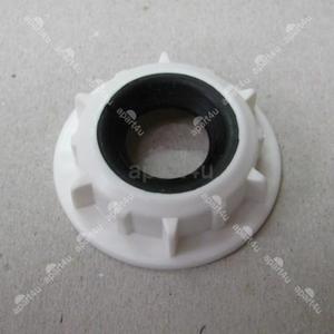

    Hotpoint FDW60 Dishwasher Problem. What is this part?
    I haven't had chance to get a new circulation pump yet but decided to try an experiment. I opened the door near the end of the final rinse cycle and allowed the machine to cool down for 1 hour. Closed the door and the programme started again, however every soon afterwards the dishwasher...
  5. P
    Thanks so much for your advice, I will try and obtain a circulation pump and give it a go. I will post an update as soon as I have confirmed that the new pump has resolved the issue.
  6. P
    I know this part well, I have replaced it on numerous occasions before to improve the Upper Spray Arm performance. The one on the dishwasher is new and so is the seal between the upper spray arm and the basket. I have even checked the little ball that moves around in the upper basket...
  7. P
    Thanks for the fast response and identifying the part on the photograph. Do you know if there is any drain valve on this model that may be jammed open, I didn't see anything during the strip down and the circulation pump looks good and appears to push enough water to spin the top arm. I...
  8. P
    Hi, My FDW60 Dishwasher stops and flashes two lights just before the drying cycle, Eco & Prewash, this indicates the filters need cleaning. All filters and pipes have been cleaned I have even replaced the drain pump. Still it will not finish a cycle and stops. The lower arm is also not...
