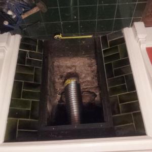

    Wood burning stove. Wooden fire surround. Distance.
    From my experience with my previous stove I know that my wooden fire surround did not catch fire but............. I am trying to get an answer about complying with building regulations. What I want to know is: if I put in a vertical metal fin between my stove and my wooden fire surround will...
    Thanks both of you. I must say I hadn't realised how expensive wood stoves are to run. Thanks for that. I am getting a HETAS installer to do the work but he said if I did some of it then the price would be lower. Especially the preparation at the opening for the stove. However, I have...
    this is meant to be a photo of the situation. but i do not know how to upload photos
    Can any of you please help me with some advice. I am a pensioner with little money and need a cheap solution if possible. I have a Victorian house with a smallish 18" wide fireplace. It has a tiled and wood fireplacensurround. I have bought a small stove which says 450mm to combustible...
