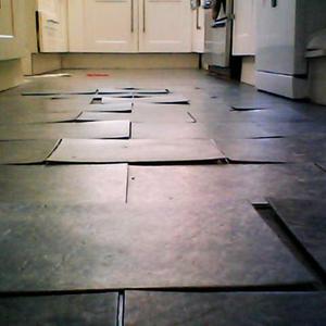

    floorboards with ply nailed down and i believe its a latex screed with amtico glue and amtico tiles. No water damage as such. It does get cold sometimes. It was laid by a professional in the trade for the last 30 years who also woked for the large reatail outlets on their new build floors. The...

    Amtico floor disaster
    My amtico floor tiles have started to turn up at the edges aswell as completely coming away from the floor. They are laid on ply with a levelling screed and amtico glue. The fitter has packed up and moved abroad. The amtico website says not to screed the plyboard and then glue. The floor cost...
