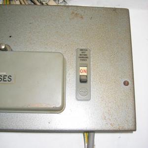

    TT to PME
    Cheers. Will take a look. The house has no RCD protection and still has old rewirable fuses. However from the loft and airing cupboard the wire does look fairly modern PVC. We are thinking about having a new CU fitted and if required a some sort of rewire, its just trying to find the cash...

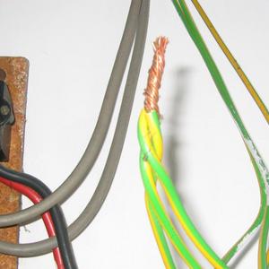

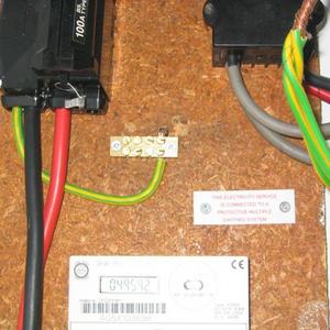

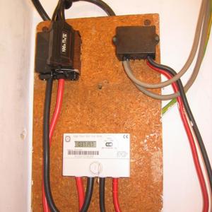

    TT to PME
    Hi We moved into our house about 6 months ago. Soon after we were told that we had a TT supply and what appeared to be no visible earth rod, the only earth bonding was to the Gas main. This is how we found the meter, earth wires and incoming supply. After many calls to the DNO...
