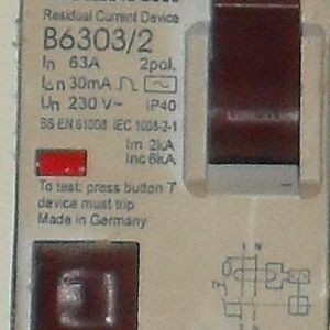

    Hi Sorry it took me a while to suss out how to post this picture,this is the rcd.

    Hello again...thanks,I have an RCD that is placed just before the consumer unit..if that makes sense.Is that ok.

    Thanks.the circuit is protected by 32 amp breaker,at the consumer unit.This is on a ring main.

    Hi,Can anyone give me some advise..I want to change a single socket to a 13 amp fused connection unit.The socket in question is a spur,then i would like to daisy chain 2 or 3 double sockets from the FCU..is this ok to do.
