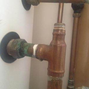

    Identifying a Fitting
    Thanks for the help guys! Denso I take it the vent on the link is just soldered on to the 15mm reducer? Thanks. DR
    Hi everyone, I am having trouble identifying a fitting on my hot water system I think it's a Solder Ring Reduced Tee 22 x 15 x 22mm but I can't work out what the knurled part at the top is (it's the 15mm part) - my mate reckons its a vent for air in the hot water system. It's fitted...
