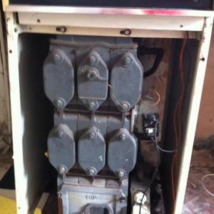

    To all I had some advice off pumbers who advised powerflush and high prices. Luckily my brother works for HSS and i got a discount on a powerflush machine.me and my dad flushed the sytem last weekedn and now the heating works even the radiator in the hallway that has never worked:)happy...

    Hey guys Sorry for delay in getting back I have tried to flush a hose through one radiator valve and water just backed up to the tap. Also tried leaving just one radiator on an closinig the others but this doesnt sem to do anything. Think it may be plumber time

    I have taken off the radiator in the bathroom and gave it a quick run trough with hose.THis is running black with lots of magnate.I had taken offf all radiators and hosed through before i had changed direction of pump(they were running clear!) so not sure if this has unlodged som gunk near the...

    Yep no thermostat on cylinder so basic gravity HW and pump CH it must be

    There does not seem to be a anti gravity valve on the heating flow pipe

    Chris the C plan looks like the systemn i have. I have not been able to find any motorised valves,where abouts would they be? I will try connecting the hose to a radiator and flushing out.

    The direction arrow is pointing to the boiler. I have pulled the plastic cap out and bled it and turned the nut and it rotated fine, We had the boiler checked out before we moved in and he said same thing

    Your right it's a myson compact circulating pump cp53,will look at moving the pump into horizontal position

    Hey guys We moved into a new house last august with an old system Its gravity fed open vented system with feed and expansion tank in the loft.A hot water cylinder upstairs.The boiler is an old glow worm balanced flue model. There is a water pump under the floor boards near the boiler...
