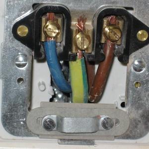

    Thank you to everybody who contributed. All the advice was spot on. The cooker is now installed and working. Funnily enough as well as putting the neutral and live in the wrong blocks, the cooker and hob switches are the wrong way round, bearing in mind one is 20 amp fuse and the other is a...

    It definately says L next to the blue cable and n next to the brown although it is hard to see in the picture. From what most people have said it seems they but the wrong cables in the wrong block and from what i gather the most important thing is to make sure the red/brown or blue/black...

    Thanks for your responses Just to clarify, this is a new build apartment from a housing association and I am the first tenant to live in it. From the responses you gave it sounds like I should get the housing association to have a look at the electric installation. I have attatched a...

    Hello everyone I need to install our old electric cooker into our new apartment, the cooker already has a cable and the electrics are all in place, so I should just need to connect it. The problem is that I have noticed that on the socket on the wall the live and neutral wires are...
