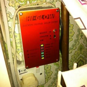

    Identify heating controller....
    Thanks, I must have a nose bleed, the technology is 80's and uses through hole and bog standard op amps and presets. No indication of function or calibration however. For the 21st century I would expect a microcontroller and SMT devices at least.
  2. R
    The sensors are 3 pin integrated circuits so none of the above ! The temperature measurement still works OK though in that the bar graph shows the right temperature, its just the pump switching which is duff.
    OK, having had a very useful response to my query on a neutralizer in my dual fuel system I'd like to ask if anyone knows anything about this box? It's the controller which turns on the central heating pump only when the hot water gravity feed gets hot enough, and has two heat sensors, one on...
