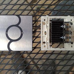

    Touch dimmer wiring query
    For info and in case it helps someone else. Reversed the red/black in the switch socket as suggested by ColJack and one dimmer worked ok. Tried same combination in other dimmer - again ok. Finally parallelled up the two dimmers (i.e. Live to L1,L1 and return to L2 L2). Both dimmers LED's light...
    Actually they are blue led's, not that it matters. Nothing in the instructions about calibrating it. And the seller indicated the whole switch could be used to control one light, so I believed him. He has since not replied to emails asking how to do this. I think I'll risk trying the two in...
    Thanks - I'll give that a go. I'd still quite like to make both dimmers connected if possible. Would that work if I just connected them in parallel, ie L1 to L1 and Live, plus L2 to L2 and return?
    I've had a look throught the wiki and searched the forum but have not been able to find an answer to this problem. Have learned a lot in the process though, so many thanks! I have a double touch dimmer which I would like to use to dim/switch one lighting circuit. Each dimmer is rated at...
