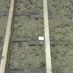

    Hi, Slow progress on Sunday! We spent most of the day crawling along the loft clearing out the eaves. Once this was done we started to top up the base layer of insulation as shown in the image below. The socket wiring (you can see in the socket in the image) has been run along a...

    So, there is a lot of usual info on this thread with all the helpful responses I've received. So I will post some updates and photos on my progress as this may aid somebody else in the future. Today I cleared out all the old rubbish and the top layer of my insulation (which had been churned...

    Hi, well this weekend the project starts. I've decided to gut the loft of its existing insulation and put down some new stuff. So the first layer of insulation going in between the existing joists. I've brought some 'Knauf Eko Base-Layer 100mm thick' (this stuff is ok?). This amount of...
