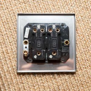

    Need Help with the Wiring of Hallway & Landing Lights
    Hi guys, As promised here's some photos. I had a little difficulty with photographing the downstairs 2 gang 2 way switch whilst the wires were connected as one of the wires (labelled L2) is very short. Here's the downstairs 2 gang 2 way switch connected and below another photo showing the...

  5. Downstairs Light Wiring
    Hi, Thanks for the response. The old switch had its terminals arranged with L1 and L2 as you illustrate in your diagram. I labelled the wires with the terminals that I took them out of but obviously this doesn't directly correspond to the setup in the new switch. I will call an...
    Hi all, I've recently replaced the light switches in my house, but having a problem with the hallway and landing lights and wondered if anyone can offer some advice. The hallway light is a 2 gang 2 way switch and the upstairs landing light is a 1 gang 2 way switch. The problem is that the...
