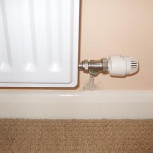

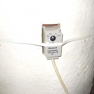

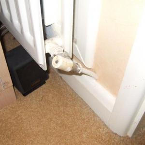

  7. R
    Vitodens 100 - Powerful enough
    The return pipe on the boiler is hotter than most if not all the radiators. The cylinder has a stat and this is set to 60c I've added some new pictures showing this. I've measured one of the pipes going into a radiator and it is 19mm diameter. I wonder with the fact that the switch box...

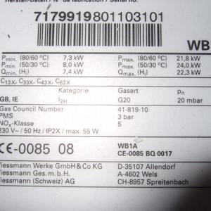

  8. R
    All Thanks for the responses. Apologies, I've just looked on top of the boiler and seen the label. I assumed I would have to take the case off.. I've added 2 photos to show the sticker on top and also the boiler when on the max setting after about 15 mins (at 73c). Normally it only goes up...
  9. Vitodens 100 Sticker
  10. Vitodens 100 on max
    Vitodens 100 on max
    Vitodens 100 on max
  11. Vitodens 100
    Vitodens 100
    Vitodens 100
