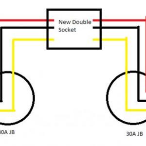

    Adding a socket using only one junction box
    Could you not do this? Sorry for bad paint skills

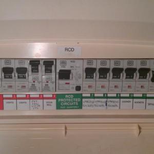

    Feed to Garage
    Supply in CU The one labeled 'Spare' has a 32A B32 in it, the one to the far right labeled sockets is actually our whirlpool bath? Don't know why its labelled as sockets by thats by the by Edit; Label on Pool pump says under HP/KW : 1/0.75 which I assume means...

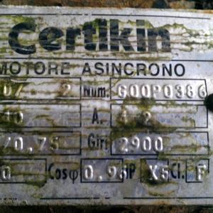

  5. R
    Feed to Garage
    Ohh, that makes sense. I'm not sure how much it actually draws, but on the motor it says 240v AC 4.2A. It is quite old, I will get a picture shortly.

  7. R
    Feed to Garage
    Okay, ill get in contact with the electrician and ask him. I think its 3 phase, it has a large capacitor on it I think to make it 3 phase maybe? Anyway, it draws a lot of power

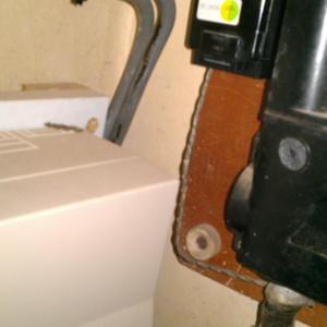

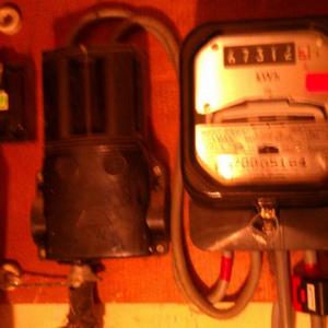

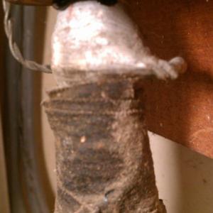

  9. R
    Feed to Garage
    Does that mean my earth is supplied via the black cable? The black cable is the feed to the biuse, the black box to the right then has two meter trails running to the electricity meter, then in to my CU The only pipes or anything going in to the garage is one blue plastic water pipe that is...
  10. R
    Feed to Garage
    I'm not sure what is supplying the earth to the house, presumably a earth rod? Its a detached house. There is only a water supply to the garage, it uses the Blue plastic piping. The walls are made of blocks, the roof is wood beems with tiled roof, floor is solid concrete
