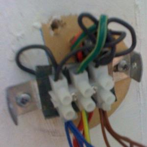

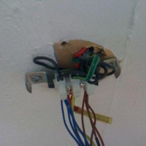

    Great big THANK YOU worked first time. :D :D :D :D :D :D :D :D

    As you can see on the 2rd photo there are two black wires in the left green/yellow in the middle and a single black wire in the right there is a red wire which has some sort of dead end on it. I took one light down and put this up in the same order as the first....

    Kitchen & Bathroom light
    Hi i moved into a new property and change the light in the kitchen and now everytime you turn the kitchen light on you cant put the bathroom light on at the same time. You can only have one or the other on. The bathroom is on the same level as the kitchen.
