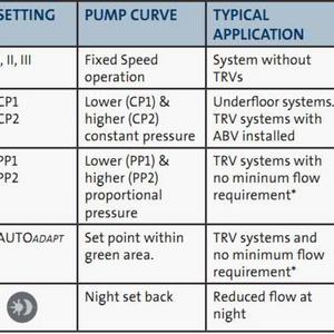

    Bump from me - nobody else have one of these pumps or knowledge of them so can offer some advice? I just want some reassurance as to the right setting so I don't cause any damage to the system. Here are some links to more info anyway. Table showing what the advice for different modes are...
