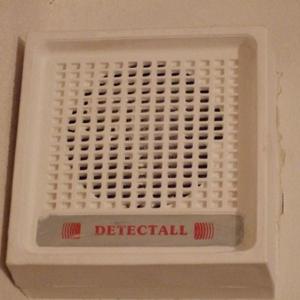

    Anyone recognise this product DETECTALL
    Yes there is an Alarm. We do arm it but I’ve never tested it so I guess that’s what it’s for. I didn’t think of that because on the alarm in our old house the speaker was internal to the alarm panel. Cheers.
  3. S
    Hi, Does anyone know what this is (picture) the only writing I can see is DETECTALL written on the front of it. I recently moved house and I'm not sure what it does?

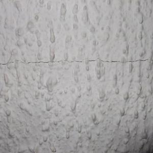

    crack in ceiling
    Hi, jhon123 The ceiling is textured. I’ve attached a photo this is a close up about 20cm away. It’s straight so I assume it runs along the ceiling plasterboard joints. What helps hide it is that the ceiling has artificial wooden beams that run perpendicular to the crack (this makes painting...

  8. S
    crack in ceiling
    Hi Robbie uk The house is only about 28 years old, its a 3 bed detached and not very big. I'm not sure if any joint tape has been used the only way to tell would be to open up the crack which I don't really want to do. I'm going to try as you suggested, this method is also mentioned in one of...
  9. S
    crack in ceiling
    I have an Artex (I think its artex) covered lounge ceiling and have noticed there is a crack that runs the whole length of it. The crack is in the centre and is a reasonably good straight line so I think it’s probably along the plaster board joints. When the room is warm it is barely noticeable...
