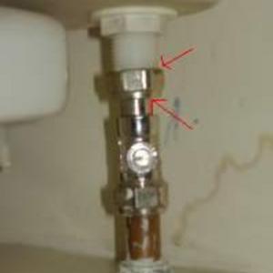

    The longer thread of the new float valve is just the right length. There isn't any tension now.

    Thanks. I just fitted a new one with a slightly longer thread. It seems OK now.

    I have a leaking flush toilet water inlet in a recent-build flat. It started leaking and I thought it was a straightforward case of changing the fibre washer. I found that there were previously two fibre washers and replaced them. Switched on the water again and it leaked. I have since tried...
